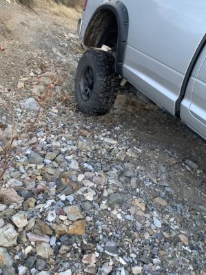

The front suspension doesn’t really gain any articulation with this lift though, right? And if you were to have the front set at the 2.8 setting you’re really limiting your “down” travel of the tire. So hitting a big bump or dip at certain speeds are not going to be very pleasant.
Rear suspension “up” travel is limited by the bump stops. Which have been lowered by the kit. And the “down” travel would be limited by the shocks? If you still are running the same shocks that came with the kit then I wouldn’t think they’re any longer than 2.5” over stock.
Maybe our take on “significant” are significantly different?
I would have needed a lot more than 2” of rear down travel for my right rear tire to stay on the ground. 8” is more likely.

I got some down travel Lol. But mines a 2500. Pretty flexy little 1500 ya got though :favorites37:
