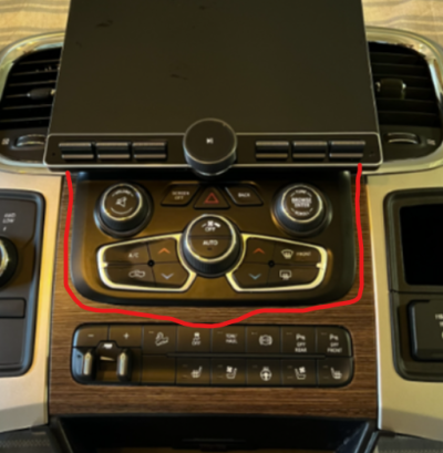

I'm trying to find a radio bezel that already has the dual hvac controls already installed. I had to uninstall and reinstall all of mine with the aftermarket radio that I went with. It was a PITA. OR..... if I could find just the auto climate controls I could reinstall those into my original bezel. and then only have to swap the bezel out to change the radio if it doesn't work. The aftermarket radio and the bezel are one piece.
