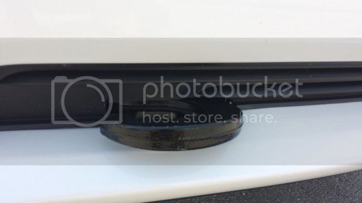

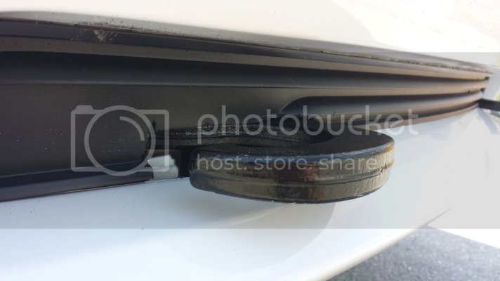

Here's the cut...
And here's the auto trim added to clean up the cut.
Sent from my HTC One M9 using Tapatalk
