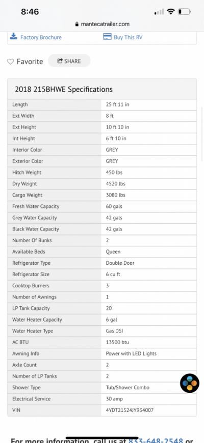

so this is what I’m looking at the trailer is 4520 pounds but the cargo is 3080. So would I have to assume I’m hauling all that weight around or just worry about the dry weight since I’m not towing it with anything inside to affect the cargo weight
The initial weight of the trailer is 4250 lbs, everything you add also has to be considered especially if you have a significant other than likes to take everything "including the kitchen sink"
This trailer description you post should have a 7600 GVWR, which is the maximum weight it can weigh with everything in it, don't overload it. Get yourself a good weight distribution hitch and learn how to adjust it properly, not the dealer will not do this correctly as the set up changes based on how much you load into the trailer. It's best to use a CAT scale to adjust a WDH. Your EcoDiesel will tow that trailer just fine even fully loaded, be sure to use the Tow/Haul mode. When towing long grades keep the rpms around 3K
