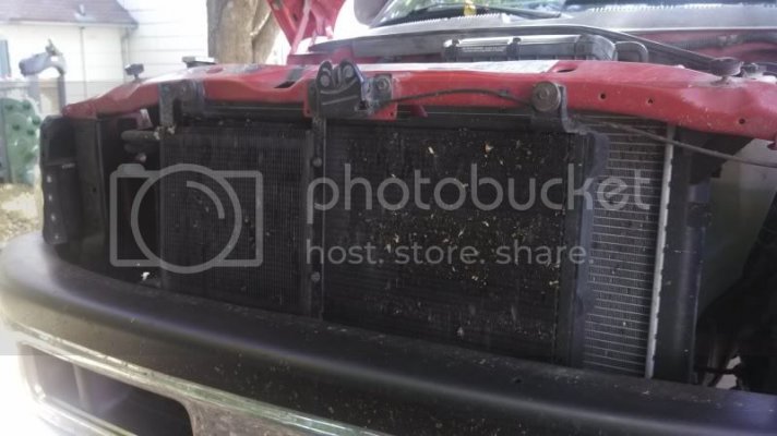

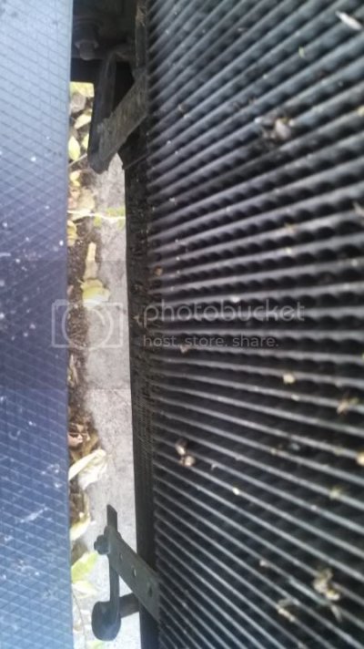

That is tiny and the fact that it is pressed up against the condenser isn't helping your issue. The guys that did my transmission added one on my truck also. Here are some pics. I pull quads in a enclosed trailer or my car trailer with something on it and never have a issue with temps.
Doesn't touch the condenser
