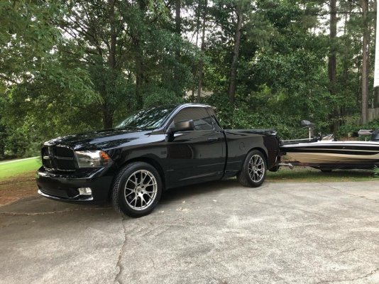

I pull a 24" Bass boat and trailer with mine... as well as back it up a pretty steep driveway with zero issues so far. But that's the most I've towed with mine so far.78f0e03b34e28037779b38661033dde8.jpg

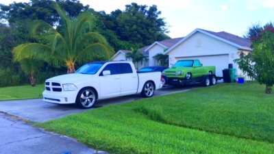

I know this is kind of an old post and my set up isnt exactly the same.
INEZ 4/6 drop, Airlift HD bags, and hellwig sway bar. I pull a 8.5 x 20 Covered wagon spread axle enclosed trailer, CURT WDH and put about 20-30# of air in the bags when I tow. The trailer comes in around 6,700-7,200 depending on how far we are going to race and what parts I bring to sell.
