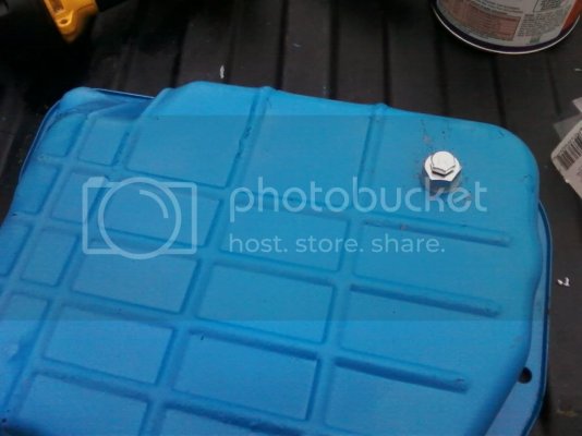

I added a drain plug to mine. Need to get mine drained again and new filter, hoping that fixes my problem

wermbang, how did you add that drain plug. what kinda parts did you use.
