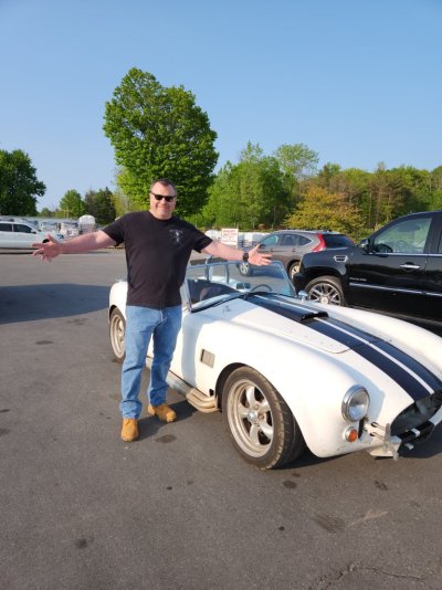

Off topic But:
Here the kit car I built. She 's dirty. I live at the end of a 1/2 dirt road not maintained by the state.
Dart block based off a 351w engine
Bored and stroked to 427
492 Hp 512Tq
Ceramic coated short headers
duel plane intake edelbrock
650 edelbrock carb
Petronix distributor
Side pipes XL
Enigine was built and dynoed by a professional on the East Coast
TKO 600 Tranny 5 forward 1 reverse
I had to install the tranny 5 times to get it right.
90 model mustang rear end. I had the gears taken out and a professional install 3:55 with locking rear.
Installed a 3 core radiator
Stuart Warner guages
CAT scale said right at 2,200 pounds

Wow i love it,at only 2200 lbs it'd be a wicked little toy.Have you ever taken it to the track.
If you have any build pic's,you should post them up in this section,i'm not the only one who'd drool on them, :Big Laugh:
