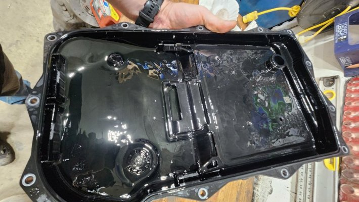

Only a f***!ng retard would say this should be left alone. This is at 85xxxkm, and its already building up sludge.
PPE pan, Maxlife , Custom Tune and a Zip Kit is a must if you plan on keeping your truck.
