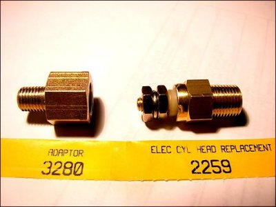

I have the factory matched trans temp gauge as well. But the sender and adapter that comes with it won't fit into the test port 3 ( located on the passenger side transmission). Therefore you have to buy the 1/8 sending unit and the 1/8 to 1/16 adapter. Once you have those you simply unscrew a plug on the transmission install the adapter and sending unit (part numbers above) and wire it up. If you need I can take a picture of mine installed.
