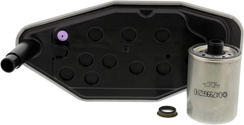

Video's are not relevant as most of us assumed 8 speed cause you didn't mention it was the 6 speed. A must item is on eBay, put this in search bar there.
45/545/66/68RFE Steel Oil Filter Adapter​
US $6.75
You need about 8 quarts for a pan drop and replace both trans filters. You will want that adapter and for less then twenty bucks it is a bargain for what it does. I'd recommend redline c+, great fluid for your transmission and is very compatible. It is pretty important to use the OEM Mopar sump filter, the one with the pink valve. Canister filter has some options, but usually Mopar OEM filters come in a 2 pack.

Burla said "A must item is on eBay, put this in search bar there.
45/545/66/68RFE Steel Oil Filter Adapter"​
Curious as to why you would need this. I'm in the middle of changing the transmission solenoid (4 week wait on part) so I got time. I already took off the filters and didn't have any problem. Wouldn't the new filter come with this piece, but in plastic? I ordered the oem solenoid, oem 2 filters and got 10 litres of mopar atf+4 fluid, a felpro gasket and rtv gasket maker.
