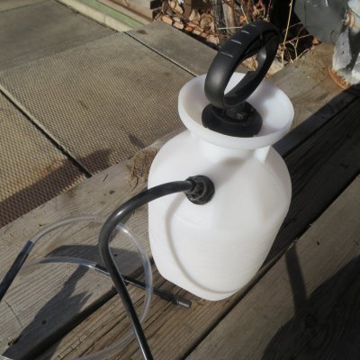

I use a modified 1 gallon garden sprayer to pump the fluid back into the transmission.
