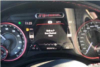

I recently purchased a used 2019 Ram Rebel and have had a few odd occurrences with the transmission. Today while driving up to a red light, right as the truck was going about 5mph, the dashboard showed a message "Shift to P then desired gear" and the D letter started flashing. As I was stopped at a red light, I quickly shifted into Park, then back into Drive and the screen went away.
This worries me as this is the second time this has happened since I purchased the truck (3 months ago). I'm going to try and atttach a video. Anyone have any idea what might be going on?

Either of you find out what caused this issue? I have a 2019 Ram Laramie 1500 and it started doing the same thing.

In my case, it was me. I was actually hitting the button on the steering wheel and didn’t realized it.

Well I got the same thing happening in a 2015 and dealer said no codes and didnt do for him so no idea..............just did it again this morning..........scheduled to take back to dealer.........
