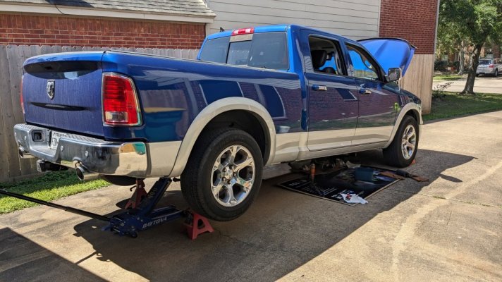

Yep. Like this. So much fun in 1 day!
Glad to see U got jack-stands there also, not just up in the air on the floor jack. Good advertisement for "safety", cause I have known more than (1) fool do things in a foolish manner.
That would be real dumb to do this with just the jack under the pumpkin, especially while having to get the tires spinning in 1st/2nd but yeah there are idiots out there. I prefer 6 ton stands for trucks. Mine have the safety pin in addition to the lever pawl.

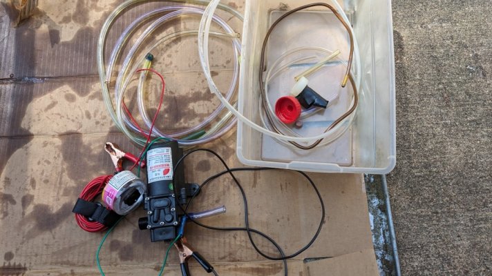

I would also try to find a 12V fluid pump. To heck with that stupid bottle hand pump.
