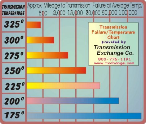

Anyhow as long as you have warranty left, check this out., apprx time your tranny will fail at that temp. Stop pulling over and letting it cool, punch it and let it fail. Don't make any statements at all when it fails, just point out the many times you had it in their shop for this issue. Go getcha a new tranny.
That may apply to the older 6-speeds (I've seen that chart or ones similar since the 4-speed days when I owned a 2001 Ram 1500), but the newer 8-speeds are designed to run very close to 200 degrees.
Regardless, anywhere near 275 for even the 8-speed and I'd definitely say a problem exists. Like others said, find a different dealer. Take a short video with your smartphone of the alarm/temperature to show it to them, in case they try and pull the whole "unable to duplicate problem" trick.
Yeah, that chart is a little out dated.
It pretty much applies to every trans besides the 8 speed.
