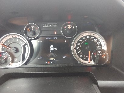

I have a new to me 2015 Ram 3500 diesel. The truck drive fine but no reverse. My question is where can I find info the Drivers Information Display (see picture)? The truck symbol on the display that has a white underlined triangle and the shifter is in reverse. I changed the fluid (smelled burnt and dark red looking) and filter.
Thank you for your help.
Sent from my XT1635-01 using Tapatalk
Does your 3500 have the 68rfe or AISIN transmission?

2:49 something to do with backup sensors or auto park?
In 2015 they rear ParkSense was just to tell you how close you were getting to something, it is not linked to the braking.
Thought it might be a malfunction in the system that won't let you open the door and backup at the same time. If that was even a thing in 15. Mine (16) wasn't but the update covered it.
Don't know if its slipping, or just won't let truck reverse.
The Auto-Park when the door is open is only on the ZF 8spd transmissions as they are electronically shifted, the RFE68 and AISIN transmissions are mechanically shifted.

The Auto-Park when the door is open is only on the ZF 8spd transmissions as they are electronically shifted, the RFE68 and Asian transmissions are mechanically shifted.
Just was hoping it was something simple, hate to hear people with expensive issues.
What's the mileage on the truck? I can't tell by the picture
