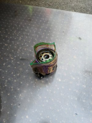

Just changed my oil for 2nd time, went a year on qsud 0w20 rp filter and 10oz of lubegard, 4850 miles.
This time i did same oil but srt filter and 15oz lubegard. Also used the ziplock bag trick removing the filter! Not a drop fell!!
