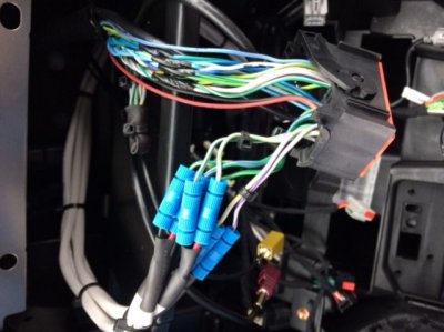

Just a post about how I got the signals from my HU for my amp with high inputs. I went to the back of the HU and used posi-lock connectors at the harness. I then ran these lines from the front of the vehicle to the rear. From that point, I have control to go high into an amp, a DSP or a LOC. If ever I want to remove the equipment from my truck, I can just unscrew one side of the posi-lock connector and re-attach the existing wire.
While I do not like cutting into factory wiring, there is no harness available yet for our vehicles with a 8.4a/8.4an. I did research getting the connectors on my own and building my own harness, it is achievable but I would have to buy the connectors, the pins, a tool to crimp the pins, etc. and it was cost prohibitive.
Here is a pic of the result. Notice the heat shrink "nub" with the zip tie on it. Those are the existing wires that I could reconnect should I ever need.
attachment.php

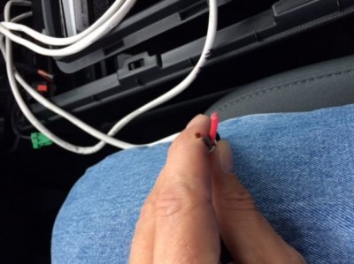

I really like these posi-lock connectors. They are really strong, re-usable and make quite a nice connection. Look at the photo below how the wire forms around a conical pin, pretty nice connection.
attachment.php

What did you think of those posi-lock connectors?

This will help A LOT of people...thanks for sharing the details with pics!
I did comment above the last photo. Bottom line, the best solution I've ever used making stereo connections. I am a fan of solder and shrink tube but after using these, the ease, solid connection and speed, they can't be beat.
Here is another testament angle. Saturday after I finished up working on the truck. I sat down at the computer and ordered two more packs of connectors. I have no need for them now but I want them on hand for any future possibilities.
