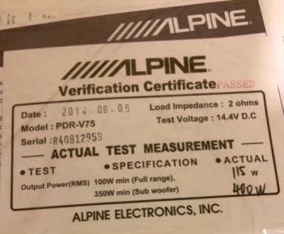

I received my amp today. Here is the verification certificate, not too shabby for what was supposed to be 75 Watts RMS Per Channel.

One problem though......When I installed it I hooked up my inputs, grabbed my trusty meter and a USB stick with a 50 Hz test tone on it and could not get it below 29.6 volts VAC with the HU set at 33 of 38. I based my math at 100 Watts x 4 Ohms square rooted so it should be 20VAC.
Even though the amp is designed for high inputs, it's a little too high for comfort. While I could be disciplined with the volume knob, if I ever let anyone borrow my truck I could see a problem so it looks like I will need to LOC.
Anyone have any opinions on line out convertors? Is there one brand that is better than the next or can I just run down to Best Buy and grab some?

Since my last post I realized my math was wrong, my VAC should actually be lower than previously stated. The Certificate is a 2 Ohm rating so it is a 15% increase over rated power. At 4 Ohms it comes out to 86.25 Watts per channel. Multiply that by 4 Ohms equals 345, square rooted equals 18.57 VAC. So at 29.6 Volts, my volume knob is maxed out at 24 of 38. Not desirable!

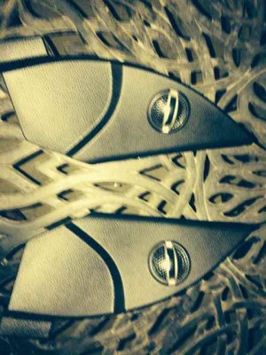

Glad your install went well! I'm taking a break from my own. It's very slow going bit I'm hoping I'll be as happy as you are :). I'm at the critical part where I have to drill my sail panels. Haven't even marked them yet. I'm sure I'll be looking at it for another hour before doing so.

Just do it! ;). They are about $15 to replace. I put the tweeters in the sails of my F150 where the sails are part of the overall door panel. That was difficult making that hole as the panels were $400 to replace. Out of boredom I could see myself moving my tweeters to the sails in my truck.

Whoa, looks very nice! But the right one is off center by 100th of a milimeter... :roflsquared:
How did you drill the holes?
Used vernier calipers from the backside. Drilled a small hole, then an 1/8", then 1/4". Used a 1 3/4" hole saw from the top. It cut nice and clean, I was surprised. I think it literally was in the 100ths of an inch off :). Sounds crystal clear. I'm not done yet. Will bridge the amp tomorrow
