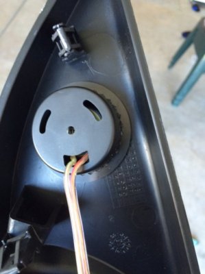

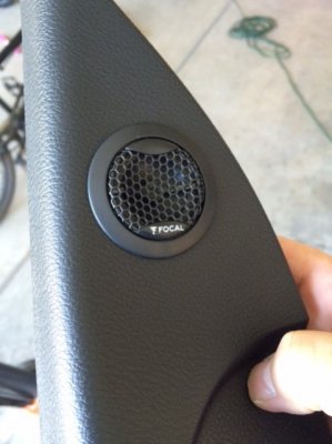

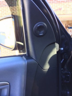

I decided to pull my tweeters from the dash today and put the as far near to the sails to get a listen, definitely an improvement. Hard to explain the sound difference but brighter and more direct but something I would recommend if you were contemplating sails or dash for your tweeters......much like everyone recommended to me but I was going to be different right? LOL
Anyways, here is a pic of the front.
attachment.php
A pic of the back.
attachment.php
And a completed pic.
attachment.php
I am very happy with the outcome. I thought the outer edges would protrude a bit since the sail surface isn't perfectly flat but they came out great. I like the compression ring Focal gives you also to secure the tweeter, talk about easy.
The wiring however was not easy, I had to run the wiring through the the doors and get through the connector and boot again, always a pain in the butt but it's done and sounds good.

Put them in your A-pillars and enjoy the sound stage!
ramdude916
Aug 15, 2013
210
20
sac
I like your yours better than mine :). I stayed away from the center because I thought it would stick out. Guess not

Thanks David.
lizardking! stop instigating! ;) LOL
ramdude, it doesn't look much different than yours, you did a nice job. I pulled my sail and placed my tweeter under it and then snapped the sail back on and it fully snapped in. That told me I had some freedom with where I made the hole so I centered it between the two clips.
I just spent an hour and a half in it running some kids around and errands. I am done! It sounds perfect! I see/hear no reason to go 3 way or DSP at this point. That of course is not to say that I won't do more down the road out of boredom but I'll wait until after the new year to revisit this. For now I'll just enjoy.
Thank you to all who have helped me along the way. I asked many questions that may have seemed trivial at times but I really wanted to be gentle to my new baby and not break a clip or scratch a panel. And of course, thank you for all of the great audio advice!

Thanks and yes they have much more detail. When I moved them to test, I instantly heard the difference and it was a no-brainer that they should have been there all along.
Originally by going in the dash I thought I could achieve a stealth install if you will and the highs would reflect off of the windshield and it would sound fine. Wrong! That deflection really hurt the quality.
I will say again for anyone who happens upon this thread, do not put your tweeters in the dash! ;)
