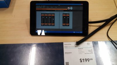

Hey David ram and troutspinner I have been lookin at windows laptops that are about 300 to dedicate as my tuning device for audio as well as my new trinity t1000. My question is I have narrowed down to 2 sizes 10.6" and 11.6" screens. Just was wondering if the smaller size will be too small to tuning software? I'm Will be running the new helix pro.
Laptop or tablet?
Well since we are talking about size, I have an 8" and is seems adequate, lol! J/k. I have the Dell - Venue 8 Pro - 8". The picture shows the PPI software open on the screen (I downloaded it onto the display unit at Best Buy before I bought it).
But I don't know about the Helix software... You might want to ask Bradknob about that, he has the HelixPro.

Yes I need a windows machine, I really like this Asus it's a 2-1 full blown windows machine 10.6" and about 350. I can tune and load my trinity as well. Small enough to keep in truck. What do u think?
Transformer Book T100TA-C1-GR(S) Net-tablet PC - 10.1" - In-plane Switching (IPS) Technology - Wireless LAN - Intel:Amazon:Computers & Accessories
Yes, that is very cool! Multi purpose and compact. I think it would be ******* to have that dedicated to tuning. I am sure it will run the Helix software, it has pc specs...
