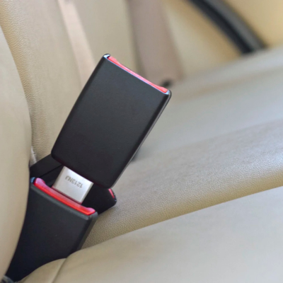

I'm a big fan of the seatbeltextenderpro.com fix. After spending about $70K or more, what's another $20? :cool:

Ram Pickup Seat Belt Extender $19.99​
When i park,
I have 3 Mirrors
The Backup camera in the tailgate handle
i can open my door, as long as i have a 3" RIGID seat belt extender, i do Not have to fasten the Shoulder Strap !!
I never remove it from my Ram

Just click the belt in before getting in truck, then get in and sit on belt. I do this every time I have to deal with hooking up or moving trailer around the yard. No seatbelt chime and you can open door when in any gear and move truck as far and fast as u want.
