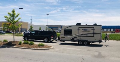

Wow you got a lot of responses on your question. I can only tell you why I have and what works for me and letting you decide
I have a 18. Laramie 5.7 crew cab 6.4 bed 4x4 3:21. I tow a 23 ft coachmen tqx triple hybrid. It max out out at 5800 But we’ll all don’t travel with our tanks full so with the kids dogs payload. I am probably at 5800 lbs. we have towed that trailer over 10000 km in the first year we have owned the truck and trailer. It worked hard on Mountain but pulled like a champ. I woo wish I had a different rear end buy I have what I have I do recommend the airbag. Over replacing the springs. ( installation bags this spring) to handle the sag with the weight distribution hitch
