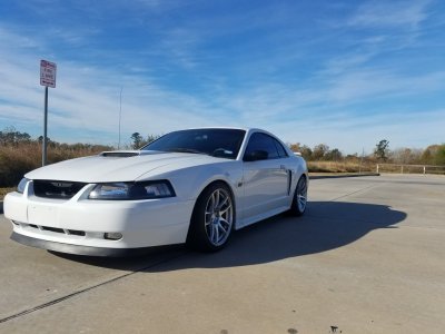

And YES.. chip.... 2003 Ford Mustang GT with a SCT 4 bank switchable chip that piggy backs physically on the ECU. Granted the SCT chip had a tune on it programmed by Bama Tunes, but still a physical chip, not an ECU flash. https://www.americanmuscle.com/sct-4bank-custom-9904gt.html And doesn't JET make a "chip" for these trucks that connects between the ECU and the wire harness?
