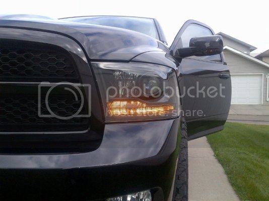

So I had JJ put Amber LED's into my new FX-R's and I turn my park lamps on with the DRLS
and it looks much better now
My first set of OEM Lamps (on my 10' that came with quads) Park Lights (tinted LED lens)
Flasher Brightness OEM lamp (tinted lens) This is how bright they "should be" ideally...
BTW...JJ had a set of OEM's on the bench one with tint, one without tint
...made very little difference at full power (trouble for *some* is only getting full power)
