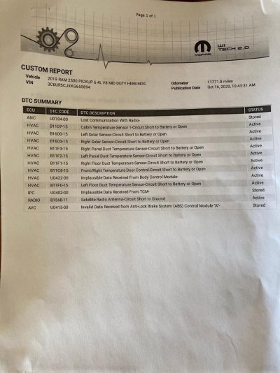

Never happened, called info, they said I need a factory flash. So I got one. Here is the result...e9ac3f4bf8e5e7e891b0ebadc931dce5.jpg
Called infotainment, they said I need todo a can is reset because I didn’t put my factory unit in while factory flash was happening. So keep everyone posted... I’m worried my trucks ****** up!
Ok, all those HVAC faults are because your BCM thinks your HVAC is configured for dual zone automatic temperature control, and the screen controls reflect that. This could ONLY have happened by using the genie. Only one of three things is going to revert that back to your original single zone manual temperature controls:
1) Infotainment gets you a genie that reverts the original genie’s programming (if they seen the faults that you just posted above, then they know damn well this is the case)
2) You have the dealer perform a “restore vehicle configuration” to the BCM
3) You get AlfaOBD and make the necessary changes yourself
Until you do one of the above steps, nothing is going to change.
