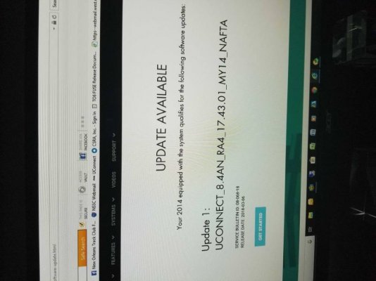

I just found this post on a Jeep thread.
Use the below VINs on the UCONNECT website to get the correct downloads.
- Early 2014 builds WITHOUT NAV use vin 1C6RR7LT5DS546368 on the uconnect site.
- Early 2014 builds WITH NAV us vin 1C6RR7NT9DS723288 on the uconnect site.
I am currently using the top VIN WITHOUT NAV and after 4-5 "Error with VIN Number" messages (I kept trying over and over) it directed me to download
UCONNECT_8.4A_RA3_17.43.01_MY13_NAFTA
I also received a link to download
UCONNECT_8.4A_RA3_17.11.07_MY13
(Thank you for sending that link to me)
I will download this, install, then install 17.43.01.

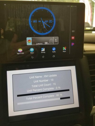

Sent from my rotary telephone using Tapatalk
Edit. Sorry, image rotated on me??

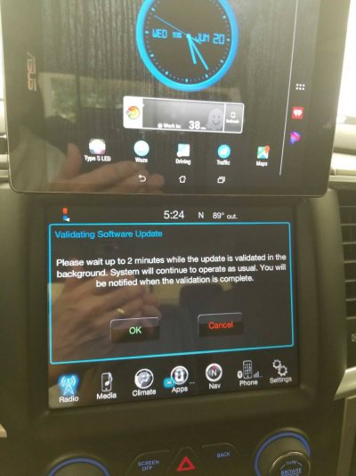

Well, finished. Will poke around, but first thing I notice is the previously missing contact caller ID is back! It now displays the name of my contact when they call.

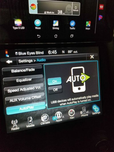

It does boot faster, and This works like a champ!76f5ccab2c378fb4b0547453fd00921a.jpg
