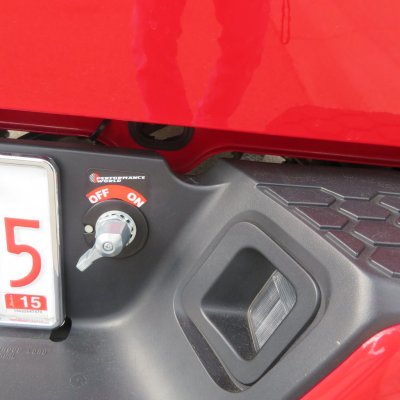

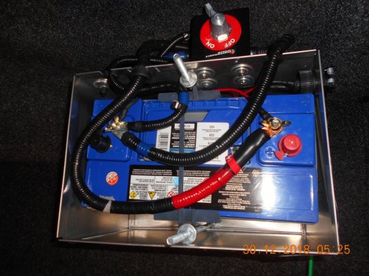

To be NHRA legal my truck has 2 master disconnect switches,it's a fully loaded 2014 Sport and i've never had any issues with killing the power on it.One switch is in the back bumper and shuts the truck down when it's running to pass tech at the local track,the other switch is on the side of the battery box,and kills everything on the truck.My wifes 1320 Challenger will take upwards of an hour to have the drag pages come back on it,when i disconnect the battery,but the radio on it,always comes back instantly.
You're comparing a 4th gen to a 5th gen. I never had any issues with disconnecting the battery on the "fully loaded" 2017 Rebel I used to own. Everything came back as soon as I reconnected the battery. 5th gens are a different animal, and some of the systems don't come back right away.
I covered that with the comment about the drag pages on my wifes Challenger,but all systems on the 5th Gens do come back after an hour or 2,they're never totally gone.
To help prevent theft he can add a battery disconnect if he so wants,but some of the trucks radio functions will take a bit to return.Which would you rather have a stolen truck,or a couple functions that take an hour to come back.
