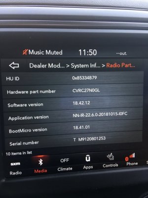

I just got my truck back from the dealer this morning. It was in the shop to get the EGR replaced and I told them about the crap audio since the OTA update so they updated the Software on my 18 Ecodiesel. My radio EQ sounds as good as the day I bought it before the OTA update. I am so glad it is back to normal, no more -6 on the bass.

I just got my truck back from the dealer this morning. It was in the shop to get the EGR replaced and I told them about the crap audio since the OTA update so they updated the Software on my 18 Ecodiesel. I was on 18.20.2e and now it shows 18.42.12. My radio EQ sounds as good as the day I bought it before the OTA update. I am so glad it is back to normal, no more -6 on the bass.
So there is hope!
Actually, the software update that is affected is the Application Version. You are now on 22.6.0; The bad version was 21.9.
Was your truck a factory UAS ? (No nav) = application version 22.6 ?

That’s correct non Nav.
OK, so now I'm wondering why your truck was a candidate for the software upgrade but mine wasn't. Both are 2018 Big Horn's with the non-nav 8.4 Uconnect system. Mine is a gas engine, yours is a diesel. Surely the gas or diesel engine can't be the difference, can it? What about UConnect would be different in a gas vs. diesel engine?
This is why I was hoping someone would get the file on USB to share.
2018 Ram UAS 4c = v22.6
2018 Ram UAQ 4c Nav = v21.9
. . . (why not 22.5 or 22.6 IDK)

Honestly, with how long all of us have waited for a fix from uconnect I really wasn’t expecting the dealer to actually update and fix it. I was shocked when I got it back and it was resolved.
I hope others on here can get theirs resolved, it is definitely beyond frustrating and unacceptable for uconnect to do this. Let me know if you need info from my truck and I will be glad to help to try and figure out why mine worked and others didn’t.
