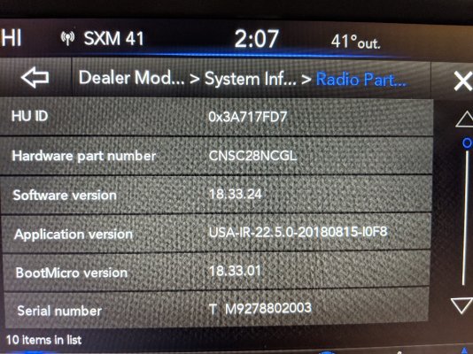

I just got my truck back from the dealer this morning. It was in the shop to get the EGR replaced and I told them about the crap audio since the OTA update so they updated the Software on my 18 Ecodiesel. My radio EQ sounds as good as the day I bought it before the OTA update. I am so glad it is back to normal, no more -6 on the bass.
How do you get to this screen to find out what you have. I have a 2018 big Horn with an 8.4 Nav system

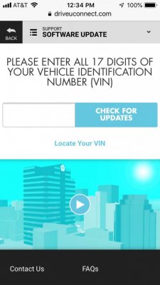

Just checked my VIN on the Uconnect Software Update site and it says I am up to date. I sure am hoping that's not correct. I called two dealers in my area to ask if they could run my VIN through their database to see if the latest update applies to my truck. Couldn't get either dealer to check outside of me bringing it in for service. Guess I'll have to take time off from work, make other arrangements for travel and leave my truck a couple days for them to check. Will be super frustrated if I go through all that only to find out the update doesn't apply to my vehicle!

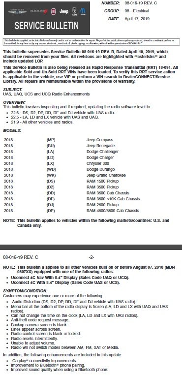

I hadn't heard back from Ram Cares in months, had given up hope and stopped following this thread. However, I messaged Ram Cares via this forum a couple days ago. Uconnect called me today. TSB 08-016-19 REV.C is applicable to my VIN and will update me to software version 22.6. Finally! Too bad it isn't yet an OTA update. Oh well. Have an appointment at the dealer Friday morning. Gonna get a free oil change while I'm there too. Looking forward to enjoying my sound system once again.
The website told me the same thing. But Uconnect called me today and said TSB 08-016-19 REV.C is applicable to my VIN. No OTA update. Need to visit the dealer. Youl should call Uconnect with this TSB and your VIN handy. See what they say. Hopefully, you'll get good news too.

It does appear that I have UAQ because I do have Nav. Hoping the 21.9 UAQ version fixes things like 22.6 does.
21.9 is the update that caused the audio to get messed up. Its the one we all want to get rid of.

Do you have a 2018 USA truck with UAS 4C radio = v22.6 or UAQ 4C Nav = v21.9 (bad audio) for the update?
PN sticker on back of 2018 USA Radio...
... 68331631AH (UAQ)
or 68331635AH (UAS)
You will need to give them a blank 16gb thumbdrive and ask them to copy the update to it and leave for you once done. Recommend you put it in a Ziploc bag with the TSB 08-016-19 Rev C reference & your VIN/contact info so they hopefully get it back with the correct file.
