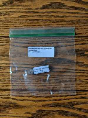

I dropped in to the dealer today and asked about getting the software patch for my 2018 Big Horn with the muddy, overly bassy sounding stereo. I had a different service advisor today and he didn't bat an eyelash when I told him why I was there. He said the process takes about two hours and he couldn't fit me in today so I made an appointment for Friday afternoon.
I was prepared to get a copy of the software update files with a blank, formatted, labeled USB stick, but he said he couldn't let me have a copy of the files unless I had permission from Chrysler. He said it was their proprietary software and he couldn't just give it out. Oh well, I tried.
Hopefully I will have good news to report on Friday afternoon.

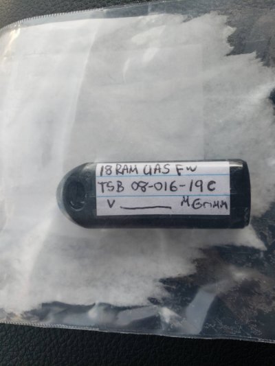

Well that's exactly what I did and ...
I need to check this when I get home but I supposedly got the UAS v22.6 file that was for my Laramie VIN.
I'm waiting for another UAS radio to arrive with v21.9 to try it out next week and will upload/share it when I get the chance.
BEWARE :
Service Writer told me there is another bulletin that came or related to it b/c some radios are not allowing the update to load. Don't know if that means the radio reset/was usable or bricked completely.
If anyone has a valid 2018 USA vin with UAQ that indicates it's eligible for the TSB 08-016-19 Rev C update let me know as I may be able to get it (but need a workable VIN).
