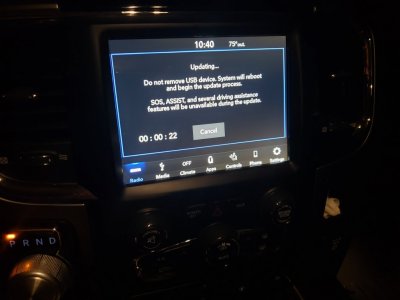

If I confirm it works all you do is download the file and extract it to the thumb drive (16gb) then turn the ignition to run and plug into the usb port. UAS (non nav only though!!)
Cstan
Sep 5, 2018
212
173
Rome, Ga

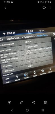

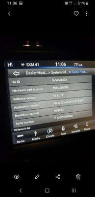

Well....after waiting 20 min :( It went through the whole process but when it restarted this is what I get..BUT everything is different now lol.
Cstan
Sep 5, 2018
212
173
Rome, Ga

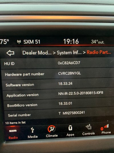

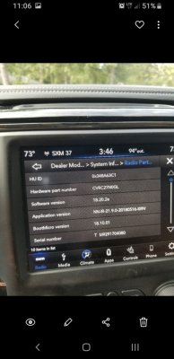

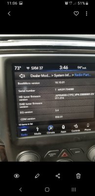

The first two pics are after the update and the second two are in September after the crap update.
Cstan
Sep 5, 2018
212
173
Rome, Ga
Audio is better. I say go for it. Thanks again Mpgrimm2
