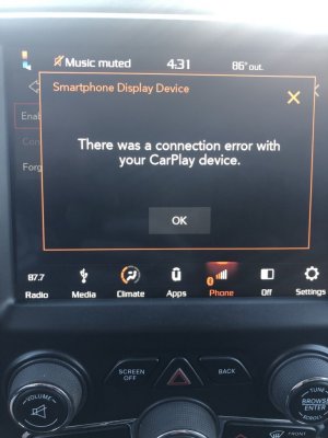

Hello all. I have the UAS that I got from salvage vehicle and it has worked great from the getgo but not CarPlay. When I plug in I get an error say”there is a connection error with your CarPlay device”. Siri works fine with the VR button. Xm. Hd radio. All other functions are great. I have tried disconnecting battery for a few hours. Nothing seems to fix it. Uconnect said to go to dealer. Dealer said go to call uconnect. Finally a uconnect person said this update was available and that should fix it. I downloaded it and installed it with no issue but still the same message. Has anyone experienced this before. Thanks.

I was thinking, I bet this is like my focus RS upgrade of carplay, usb hub may need to be upgraded. Worth a look!
If your hub has one USB port and one charge only port it's the wrong one
