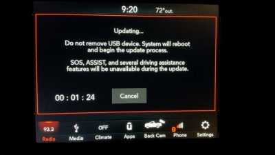

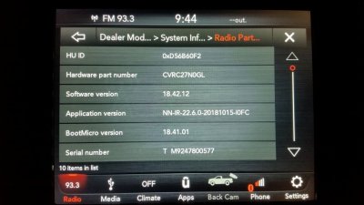

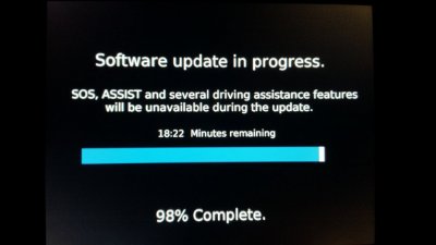

FYI for those that ran the UAS 22.6 update & notice any glitches...
It may be worthwhile after it finishes the update to do a power reset by either disconnecting the battery or pulling the inline radio fuse (20A) near the brake booster.
One of the early 13-17 Ra4 updates had a bad camera image until the reset was done afterwards.
