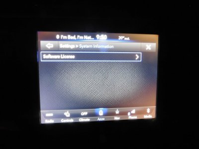

I am having a similar problem attempting to update to 18.45.01. It does nothing and I confirmed only the 5 files were on the root of the thumb drive. To confirm it was reading the drive I also put an MP3 on the drive and it played fine without issue. When I go to System Information it is completely blank even though it should have information for firmware version, maps etc. Any help is greatly appreciated, I just purchased the truck last week. Pictures are what I receive, this is frustrating. Without any information under Sys Info I will never be able to update my maps for navigation either.DSCN0812.JPG

I put my VIN in and was returned with needing 18.45.01 update. It looks like all the other RA4's, I don't know why you would say that.

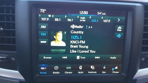

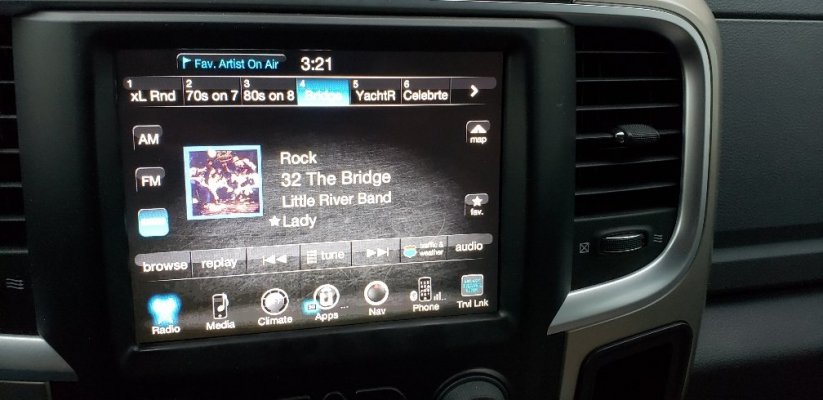

The radio you are showing a picture of is not a Harmon 13 to 17 RA4. It looks like a Panasonic UAQ. The RA3/RA4 has completely different screen graphics and icons. If you bought the truck used it may have been changed by the original owner. It's a common upgrade to gain Apple Car Play and Android Auto. Uconnect has no idea that your radio has been changed so the website is showing the Firmware version for the radio that's supposed to be in your truck. I changed to the UAQ as well but put my RA4 back in because I didn't care for the UAQ. This is a picture of an RA4 and then a UAQ. You can see they are totally different. Your firmware won't update because it doesn't belong in that radio.a2ec78f12bedb447d5ceb0e8d9d99de3.jpg717f55a1bd29ccb15818b66abff5287f.jpg
