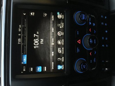

Also in playing with the settings on my radio I found that in settings and display there are 2 new options for display. 1 is Blue outlined and 1 is red outlined on the screen (looks to be from the Rebel). Pretty cool for a free upgrade. Sorry about the rotated photos, don't know why that is happening.
