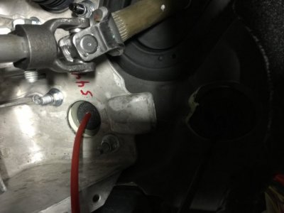

Power wire thru firewall.

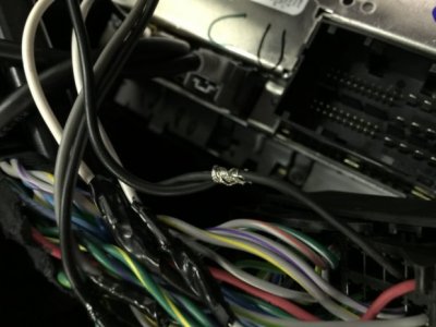

I tapped into my rear speaker leads and ground. I soldier all connections and then tape.

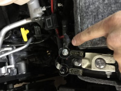

Ground wire.

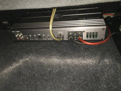

I mounted the amp under the rear seat.
