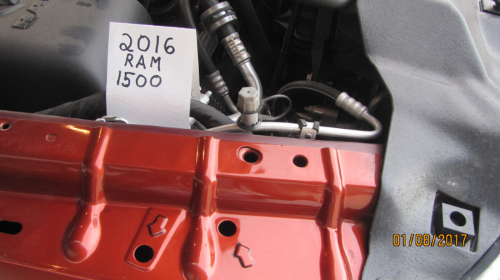

The 2013 Rams, may or may not have 2 holes for adjusting the headlights in the fenders
2009 Dodge Ram adjustment hole
2016 Ram
N

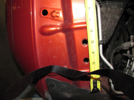

They cant be accessed from the factory adjustment holes. See attached photo for locationedit.jpg
