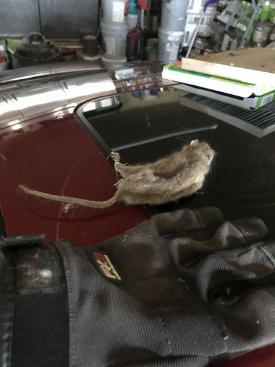

I found this last winter when I changed cabin filter in car…..D4858662-9FC6-4C98-AEFB-4A76C540C20E.jpeg

I was surprised at no signs of chewing to try to get out. Either froze to death or roasted.
