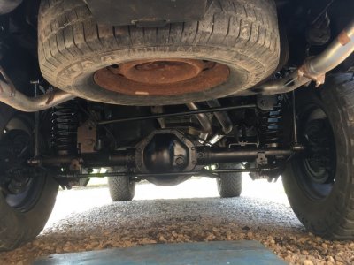

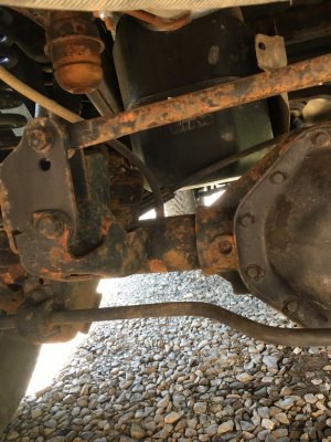

That works great there, because you can reach it.
But what about the wheel well above the wheel well, every inner body panel, inside the frame (and between the frame and the body), the underside of the body itself, etc. Also inside the doors (for the bottom edge that seems to always rust out), inside the rockers, inside the tailgate.
Spraying oil is a whole lot easier to get into those spots. I sprayed my truck with Corrosion Free a month after I bought the truck (and about 1 year later) and the rear diff looks like it did on day 1.
