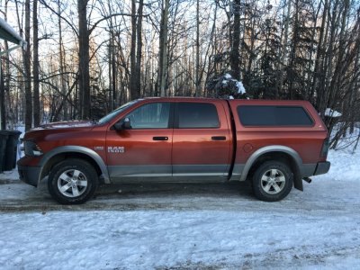

All of the above.
THEN.....
Get rid of the $300 tonneau, spend $3K on a matching topper and be EVEN MORE AMAZED at how much more dry and clean your bed stays. Double mic drop.
