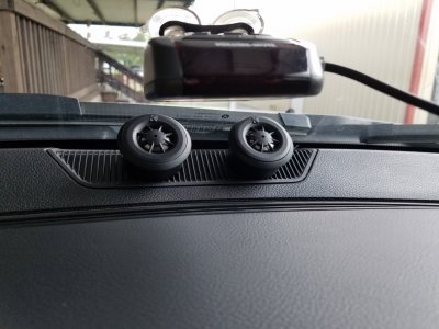

I mounted my tweeters in on top the center speaker grill. I had to remove my kicker 3.5 ks dash speaker. Way to bright on an amp.
