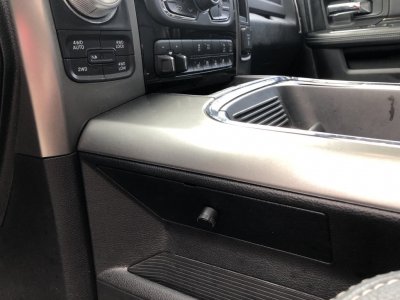

I’m very proud of myself. I went out of my comfort zone. I took the console apart, which was quite simple actually, (just a bolt and 2 screws). I ran the wires under the door kick plates (just tucked the wire under them in place), then drilled a hole in the panel as seen in a couple of other threads.
I’m not sure if the kicker guys had the problem as I did with the threads on the bass knob not being long enough to get the washer and nut on, but I can tell you the alpine rux.2 it can’t be done! I ended up using my favourite crazy glue called 2P10 to fasten the body of the knob to the inside of the panel after I used a sharp chisel to smooth out the little ridges. It’s not going anywhere now.
Anyways, the bass knob looks sleek now and works great! I’m 1 step closer to reaching my audio goals. This stereo upgrade is one of my favourite mods that I’ve done.
