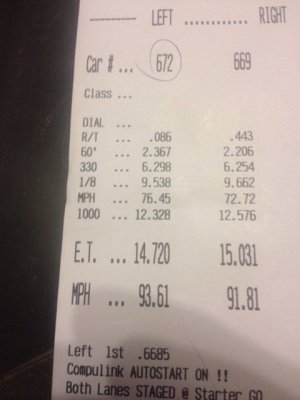

Got 10 runs in tonight. My average 60 before the VB work was 2.19 and after tonight's runs after the VB work is 2.51. DA was 2766:puke:
Best run was [email protected] and DA corrected is [email protected] still slower than my other runs. Nothing on the truck changed. This is my first track test with the new VB and is not my final review but the numbers don't lie. Even with a DA corrected time better than before would have made me happy, but worse is not what you want to see after you spend $$ on a mod. Stay tuned review still in process.

1st off... A valve body wont cause you to lose low end hp/tq. It only changes the shift pressures for firmer/faster shifts. Your small time differences and loss of low end is probably attributed to warmer weather higher DA different fuel etc.

DA defiantly had an affect. But there is one thing that everyone can agree on, I know my truck better than anyone else and everyone knows their truck better than anyone on the forum. And the bottom line is my truck is slower, tested at the track and with the t1000 my average loss is .25. How? Why? I have no idea. I was told the tranny is in a learning curve and to give it time, I'm trying to stay optimistic but I'm honestly bummed.
Looking at the glass half full I will say the shifting characteristics changed and it's stronger at the big end of the track. Before the VB I would have to shift from 2P to 4th and when I did I got a huge RPM drop and it would fall on its face. After the VB work I can cross the Finnish line in 2P at about 6300 RPM's still pulling hard. Again, don't know why but it's something I can work with. Getting a high stall to compliment the VB work is what I'm focused on right now.
