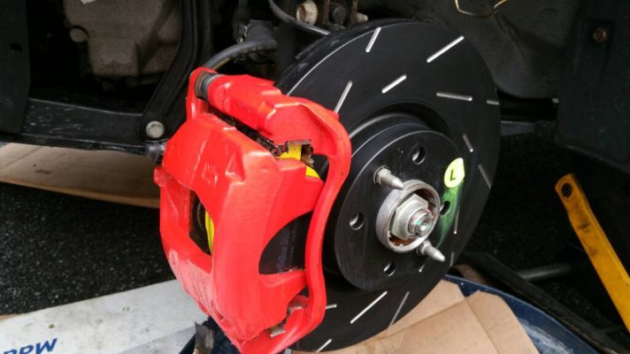

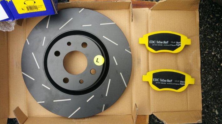

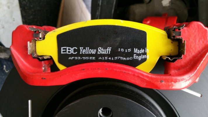

Assuming nothing more than very spirited street use, EBC Yellow Stuff pads were a not too expensive upgrade on my '09 Ram 5.7. Far better than stock.
I put them on my Fiat Abarth too.
Pics are of the Abarth brakes but, I put the same rotors on both also. I drove both at 10/10ths very often without any brake issues. They are not track brakes just very good street brakes that fit stock calipers.
Thats my 09 Ram I traded in for the Abarth next to it.
EBC Yellow Stuff going on my '17 Crew cab when stocks are worn out, if that tells you anything.
