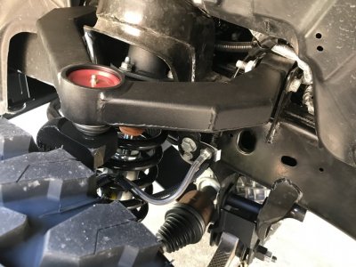

The Zone control arms are probably your next choice. They are heavy duty and correct for the angle/length needed. After that I think rough country makes some that cost a little more and then if you want look at ICON and few others that are $800 and up for the pair.
I went with the Zone arms on mine, I also liked the fact that they use a Moog BJ that can be sourced locally if ever need be.

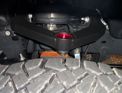

The only issue I had with my JBA’s was the color. Had them powder coated black. Much better! Gained 2” of wheel travel when they turned black too.I went with the JBA UCAs. They are built well and at the lower range of the expensive scale. I like them and have had no issues.
