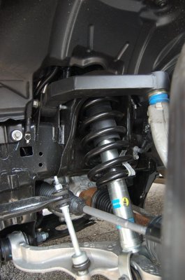

Hello Caldwell
Here are pix of my Bilstein @ 2.1" and Zone Offroad upper control arm
install which went very smoothly. The ride is Great!!!
