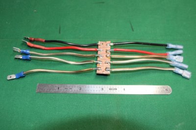

UPDATE: OK... had to know what the ASD (Automatic Shut Down) relay was doing... built a short break-out harness to insert between the vehicle's ASD relay socket and relay.. Sure enough, after about 5 min. of running, the PCM cut the ground for the relay and therefore ignition, and fuel were immediatly cut off. To build this break-out harness, I used 10 ea 4" lengths of 16 gage soldered to a 1" x 3" printed circuit to form five conductor paths. At one end of a group of five, I crimped male spade-style connectors to plug into the relay's socket on the Power Distribution Center and on the other set of five, I crimped female spade-style connectors to plug the relay into. (TAKE EXTREME CARE IF YOU DO THIS, PAYING ATTENTION TO THE PROPER WIRING HOOK-UP). With this break-out harness, I was able to monitor the voltage state at the relay's pin 85 (or any other relay pins, for that matter) from the Powertrain Control Module, pin C3. Pin 85 is grounded (controlled) by the PCM during normal (running) operation. When the PCM senses a significant problem, it disconnects (isolates) that pin, C3, from ground. So the relay reverts to the power off state and one will read battery voltage on pin 85 at the relay. It went like this... After starting, I saw a tiny voltage on pin 85 showing that the relay was grounded by the PCM. Sure enough, after about 5 minutes running, the pin 85 voltage rose to battery voltage and the engine, of course, died. Pin 85 voltage would not go low again when attempting a re-start. As usual, I had to wait a long time before I could re-start the truck (e.g. the relay's pin 85 was grounded by C3 of the PCM during start and running.IMG_3026.JPG
