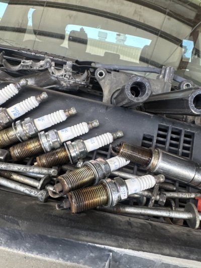

178k miles. Replaced all lifters, shaft, and oil pump with all mopar parts. Install went smooth, but as soon as I cranked it, it starts ticking. I gave it about 10-15 minutes of running and it still hasn’t gone away. Motor runs a little rough also so I just shut it off. Going to take the valve covers off tomorrow to see. Any other advice? Attached a video of the tick.

image.jpgPulled the plugs because I didn’t do it before. Gonna be replacing them and cranking it up again as soon as I get everything together.

I didn’t see anything wrong. I just put everything back exactly as I did the first time. The #1 plugs were pretty fouled out though.
