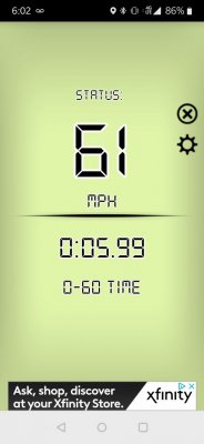

Which would you do first? Vararam or Pedal Commander?
I did the Vararam first but wish I would have done my Hikeit throttle controller first. I have a 2017 Big Horn Crew Cab 2WD and 3:21 gears and run a 0-60 time of 5.99. Just did a run this am 3/4 tank of gas and about 100lbs of junk in the bed. Hope this helps.Screenshot_20210115-060248.jpg
